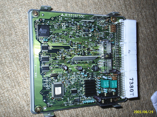

Postby GTODesign » Tue Jan 31, 2006 12:15 pm
Evo 4 PCB for reference...
Evo 4 PCB
GTODesign
Posts: 81
Postby cboles » Tue Jan 31, 2006 12:22 pm
Could you get a close up of the CPU chip with the sticker/label on it? Can you remove the sticker+glue with mild solvent to see the part lettering on the chip below?
Postby GTODesign » Tue Jan 31, 2006 12:32 pm
E4 chip
Evo 4 chip closeup
GTODesign
Posts: 81
Postby GTODesign » Tue Jan 31, 2006 12:37 pm
Under the label
MH6371F
ED04
76E56F-FFFB
JAPAN 6F1282

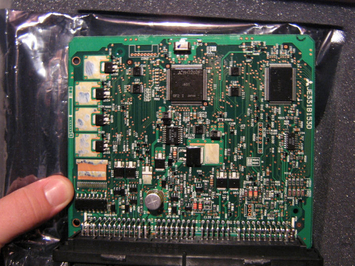

Postby wattsg » Mon Feb 13, 2006 9:41 pm
I've got an evo 5 - the board is out of the car as i'm currently running Motec - but i'll be able to experiment on people's behalf, or even lend the board if it's return is promised.
g.
wattsg
Joined: Thu Dec 01, 2005 11:39 pm
Postby wattsg » Wed Feb 15, 2006 5:08 am
Evo 5 PCB for reference - pardon the thumb
That's a 7202.
